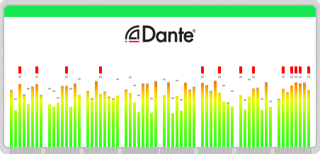

On the web remote, the Dante input is shown as an expandable tile with all incoming audio levels:

The signals that are received via Dante are shown within the input section:
It is not possible to see where the signals are routed from the input section on the device. Routings are created and inspected within the output ports.
