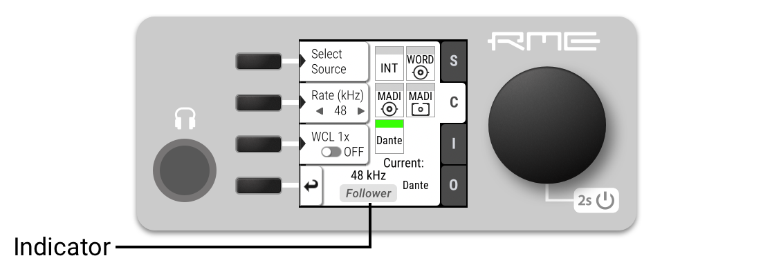

The current state can be observed in the Dante controller, the web remote and the device display:
Follower Indicator
Follower Indicator

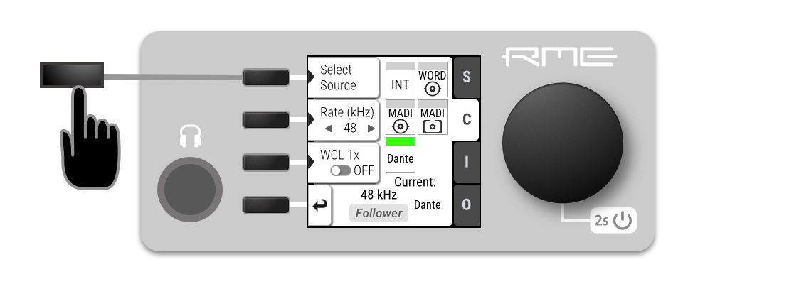

  1. Enter the CLOCK section (see Controlling the device).
    reference clock
  2. Push the first button: Select Source.
    reference clock
  3. Rotate the encoder until the preferred clock source is shown.
  4. Push the encoder again to activate the setting.

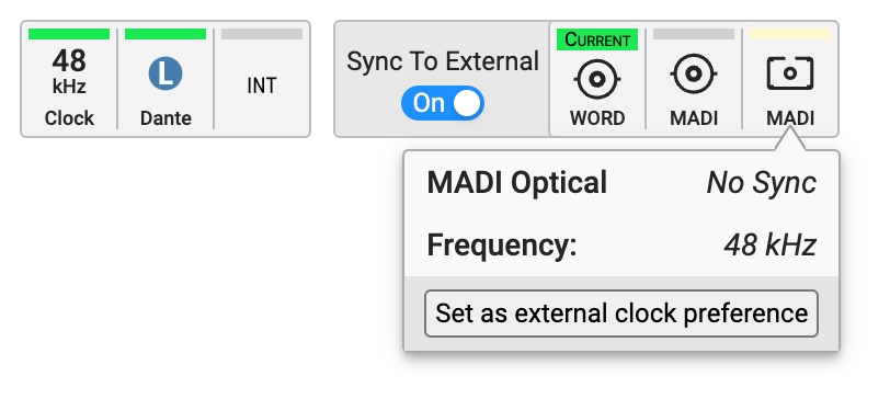

To configure an external clock preference using the web remote:
  1. In the Clock panel, locate the button for the corresponding clock and click it.
  2. Within the dropdown, press Set as external clock preference.
