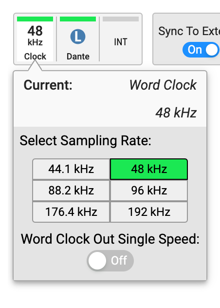

To configure the device sample rate on the web remote:
  1. In the clock panel, click the first icon containing the current sampling rate.
  2. Select the new sampling rate.
