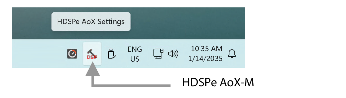

After a reboot, the icons of TotalMix FX and the Settings dialog appear in the notification area. Depending on the Windows version and configuration, it may be necessary to change the task bar settings so that the tray icons are not hidden.

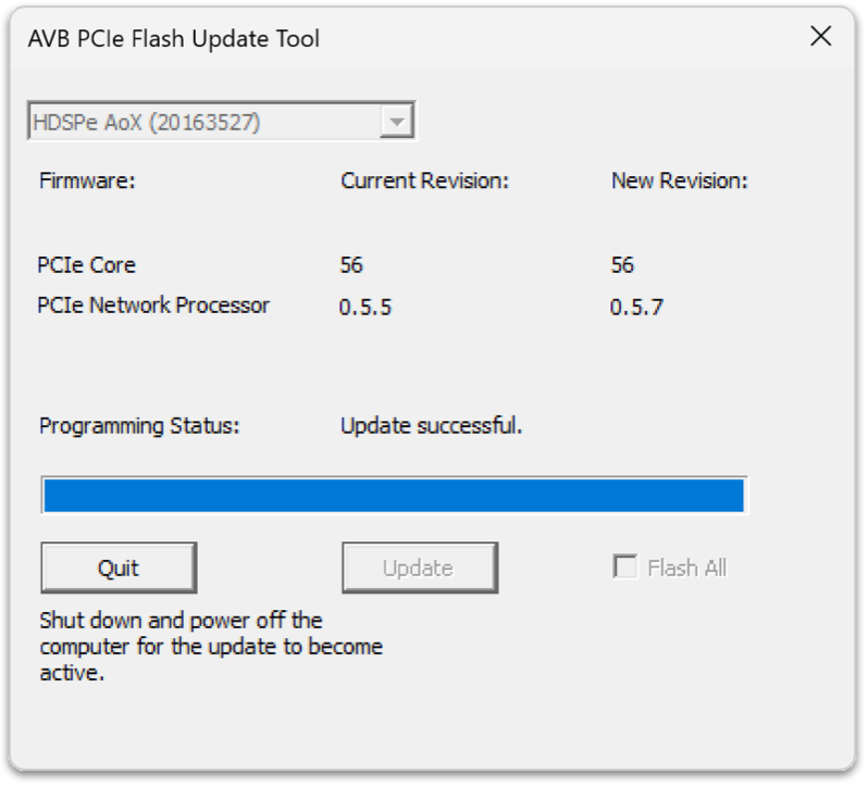

To update the firmware with the Flash Update Tool
  1. Download the latest Firmware Update Tool from the RME Website and unzip it.
  2. Start the program executable file.
    The Flash Update Tool will display the current revision of the HDSPe AoX-M and indicate whether an update is needed. If an update is needed, press the Update button. A progress bar will show the update status. The bar moves slowly during the programming phase and faster during verification.
  3. If more than one interface card is installed, switch to the next tab in the tool to update additional cards. Repeat the process for each card as necessary.
  4. To load the new PCIe Core firmware, power off and then power on the computer.
    A computer restart is insufficient to reset the card on some computers because the PCIe slot will maintain its power supply. Therefore it is recommend to always power off the computer after a PCIe Core update.
  5. The card will load a PCIe Network Processor firmware automatically. This process does not require a reboot.
If you want to downgrade the card to an earlier firmware version, select the Flash All option in the tool. By default, the tool only updates parts of the firmware that have a newer version.
If the update fails (status: failure), perform a cold boot of the PC.
The card’s secondary firmware will be used (Fallback), keeping the card fully functional. Try the flash process again on a different computer.
