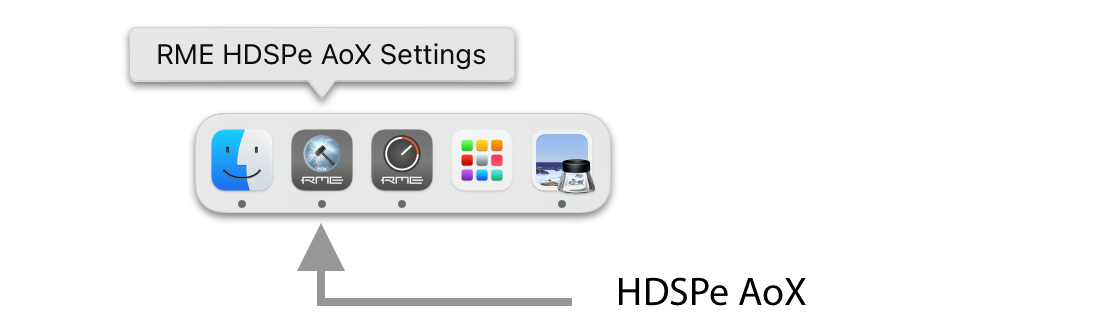

During driver installation the programs HDSPe FX Settings and Totalmix (TotalMix FX) are copied to the Applications folder.

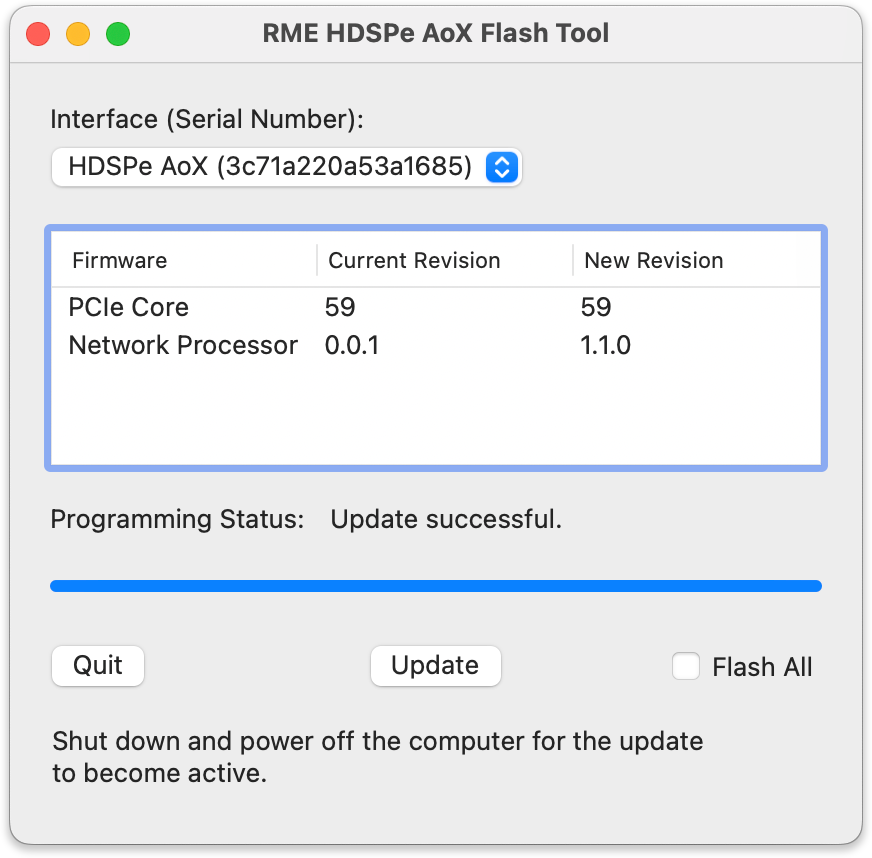

The Flash Update Tool (FUT) updates the HDSPe AoX-M to the latest firmware version. It requires a previously installed driver so the card can be detected by the update tool.
wHA 711 4T 1
To update the firmware with the Flash Update Tool
  1. Download the latest Firmware Update Tool from the RME Website and unzip it.
  2. Start the program executable file.
    The Flash Update Tool will display the current revision of the HDSPe AoX-M and indicate whether an update is needed. If an update is needed, press the Update button. A progress bar will show the update status. The bar moves slowly during the programming phase and faster during verification.
  3. If more than one interface card is installed, switch to the next tab in the tool to update additional cards. Repeat the process for each card as necessary.
  4. To load the new PCIe Core firmware, power off and then power on the computer or expansion chassis.
    It is important to interrupt the power supply to the PCIe card (by powering off the computer or expansion chassis).
  5. The card will load a PCIe Network Processor firmware automatically. This process does not require a reboot.
If you want to update all parts of the firmware including the fallback firmware, select the Flash All option in the tool.
By default, the tool only updates parts of the firmware that have a newer version.
If the update fails (status: failure), perform a cold boot of the PC.
The card’s secondary firmware will be used (Fallback), keeping the card fully functional. Try the flash process again on a different computer.
