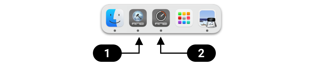

The panel 'Settings' can be opened by clicking on the hammer symbol wAL co 1 in the task bar notification area.
The mixer of the interface, TotalMix FX, can be opened by clicking on the knob symbol wAL co 2 in the task bar notification area.

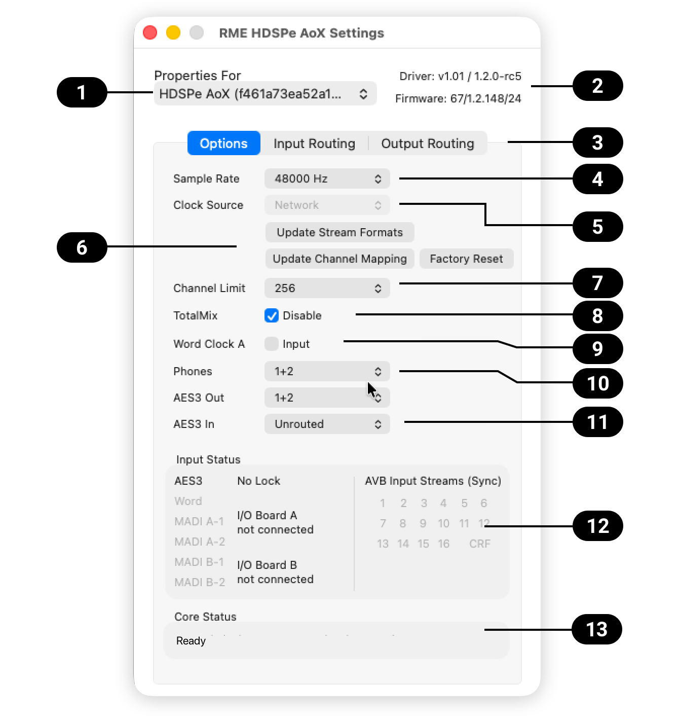

Settings Dialog Overview
wHM 712 3C 1
wAL co 1
Card selection
wAL co 8
Disable TotalMix
wAL co 2
Driver and Firmware version
wAL co 9
Word Clock A Jack
wAL co 3
Input and Output routing
wAL co 10
Phones Routing
wAL co 4
Sample Rate
wAL co 11
AES3 Routing
wAL co 5
Clock Source
wAL co 12
AES3/MADI input status
wAL co 6
AVB related controls
wAL co 13
Core status
wAL co 7
Channel Limit
wAL co 1 Card Selection
When using more than one HDSPe AoX card.
wAL co 2 Driver Information
Shows the current firmware and driver version.
wAL co 3 Routing Setup
The routing setup dialog is divided into Input and Output Routing. The input routing is used to replace blocks of 64 network input channels with signals from the MADI extension modules. The output routing is used to copy any block of 64 playback channels from the driver to the MADI extension modules.
Clock Mode
wAL co 4 Sample Rate
Used to set the current sample rate. This is the same setting as in the Audio MIDI Setup, just added here for convenience.
wAL co 5 Clock Source
In a MILAN network, the HDSPe AoX-M can act as a media clock leader or as a follower. If another entity in the network generates the media clock for the network, select 'AVB CRF Input Stream' as clock source and use MILAN Manager to connect the corresponding stream automatically. If a clock source other than 'AVB CRF Input Stream' is selected, the clock source is used as a reference for all digital input and output signals. Other entities on the network should use the HDSPe AoX-M CRF output stream to synchronize to the card.
Most of the MILAN® or AVB related settings must be configured externally using an ATDECC controller such as MILAN Manager. However, basic convenience functions are included to accelerate re-configuration of the endpoint after a sampling rate or stream size change. Refer to AVB Configuration Commands for a detailed explanation.
wAL co 7 Channel Limit
Allows reducing the number of available channels of the driver. This can be useful if the driver is used in a system with limited resources, or if the user wants to reduce the number of channels to simplify the channel selection dialogs.
wAL co 8 TotalMix Disable
Disables TotalMix FX. This is useful if the driver is used in a system where TotalMix FX is not needed.
wAL co 9 Word Clock A Connector
The Word Clock BNC jacks on the optional MADI extension boards act as outputs by default. The checkbox 'input' can be used change the Word Clock BNC of the expansion module in Slot A to act as an input instead. The incoming signal can then act as the clock source of the card.
wAL co 10 Phones Routing
This drop down field sets the routing of a pair of software playback channels (or TotalMix outputs) to the headphone outputs.
wAL co 11 AES3 Routing
The source channels of the AES3 output can be set here. It can either be a submix created in TotalMix FX, or one of the additional software playback channels of the driver. When selecting channels for the AES3 input, they replace the currently selected Milan® or MADI input channels configured in the input routing.
wAL co 12 Input Status
Displays the state of the current input signal:
  • Clock state (No Lock, Lock, Sync)
  • Sample rate (coarse) .SyncCheck RME’s exclusive SyncCheck technology provides an easy to use indicator of the current clock status. The clock state column indicates whether no signal (No Lock), a valid signal (Lock) or a valid and synchronous signal (Sync) is present at each of the digital clock source inputs.
wAL co 13 Core Status
Reveals basic status information about the card’s network core.

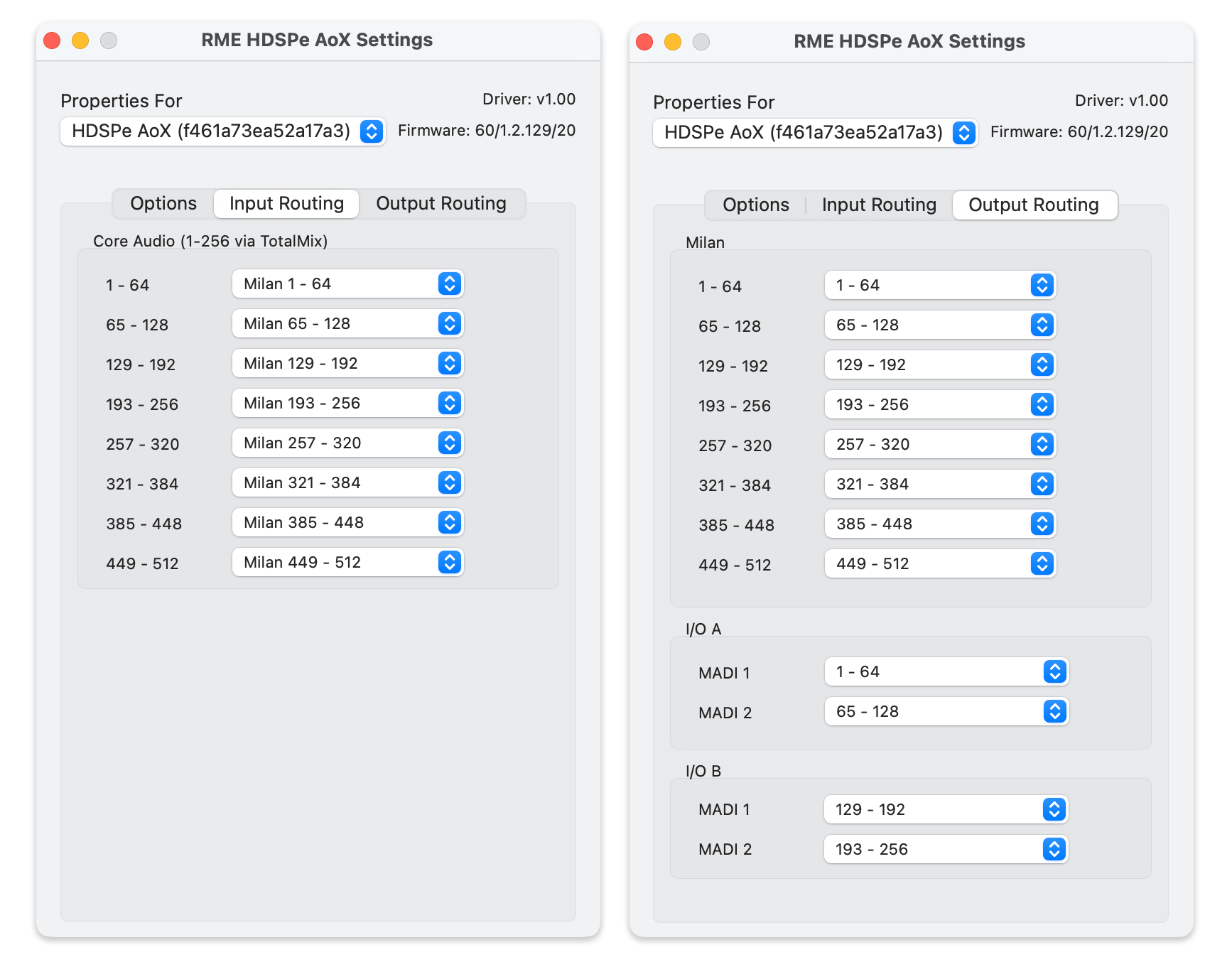

The driver of the HDSPe AoX-M supports bi-directional transfer of up to 512 channels. As the total number of inputs and outputs can exceed this number, a pre-selection of channels can be made in the corresponding input and output dialog.
wHM 712 4C 1
The Main Option’s AES3 input configuration will supersede the setting in the input configuration dialog. For example, if the signal from the first MADI Extension A is routed to channel 1-64, but the AES3 input configured to input 1 and 2, then only the remaining 62 channels of the MADI input signal will be routed to TotalMix and the recording software.
