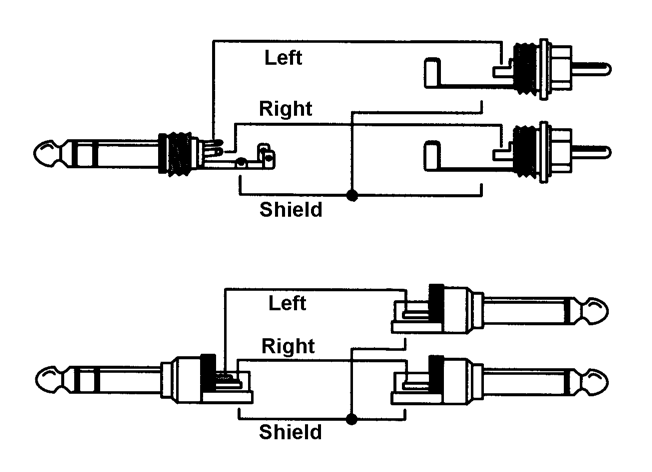

In case the output should operate as line out, an adapter TRS plug to RCA phono plugs, or TRS plug to TS plugs is required.
The pin assignment follows international standards. The left channel is connected to the tip, the right channel to the ring of the TRS jack/plug.
