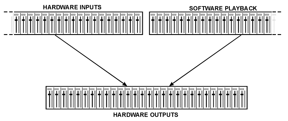

  • 2-Row View: A simplified, horizontal view for quick access.

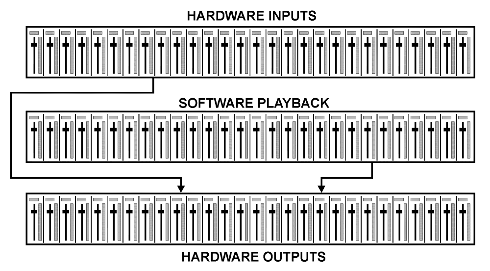

  • 3-Row Inline View (Default): A vertical alignment resembling an Inline mixing desk, where software playback channels act as the Tape Return of a traditional mixer.

Channel Rows and Functions
Top Row: Hardware Inputs
  • Displays the input signal level, independent of the fader position.
  • Inputs can be routed and mixed to any hardware output (bottom row) using the faders and routing field.
Middle Row: Software Playback Channels
  • Represents playback tracks from the audio software.
  • Playback channels can be routed and mixed to any hardware output (bottom row) via the faders and routing menu.
Bottom Row (Third Row): Hardware Outputs
  • Adjusts the total output level, such as for connected loudspeakers or reducing an overloaded submix.
