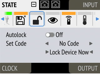

Open the lock tab in the STATE section (see Use of the Display and Encoder).
(optional) Set Code: enter a four to six digit code with the encoder.
(optional) Activate the Auto Lock toggle to lock after one minute.
(optional) Select Lock Device Now to lock immediately.
| Remember or write down the code shown in SET CODE. It is not possible to unlock the device without this code. A unique secondary code (PUK) can be obtained from RME Support upon request with a proof of purchase and device serial number. |
To delete the code, move the cursor on the code and push the encoder. "No code" will be displayed.
Deactivate the lock by toggling the switch to:
OFF -
(optional) Move the encoder onto the lock code (if any), and push the encoder to delete it.
