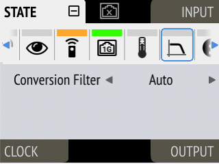

To change the aliasing filter on the device:
  1. Open the STATE section (see: Use of the Display and Encoder)
  2. Use the encoder to open the filter tab:
    w16 180 2T 1
  3. Select the preferred aliasing filter.

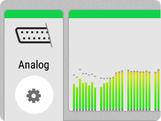

To change the current aliasing filter on the web remote:
  1. Click an analog channel group to reveal its channels
    w16 180 2T 3
  2. Click the icon that appears within the corresponding analog channel group. A modal dialog appears to change the aliasing filter.
    w16 180 2T 2
