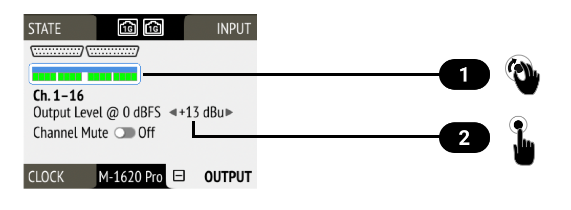

Adjusting the Output Line Level

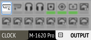

Open the Analog Output Configuration tab in the OUTPUT section.
Initially, the cursor will highlight all output channels. To accept this, rotate the encoder to move the cursor to the current reference level.
Alternatively, pressing the encoder on the channel strip allows the selection of an individual channel.
Cursor (current channel)
Output Reference Level
Move the cursor to the current line level and push it.
Rotate the encoder to change the setting and confirm by pushing the encoder again.

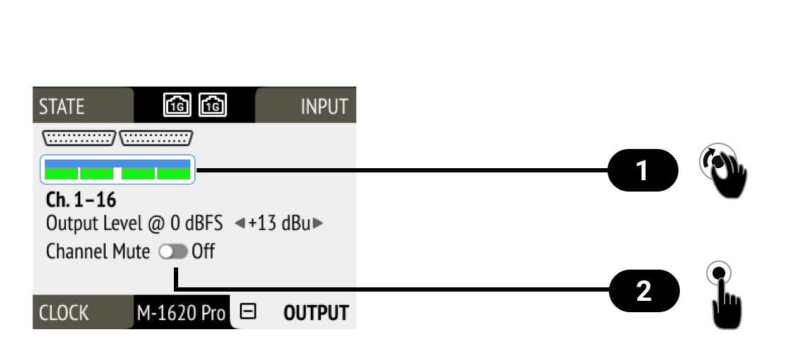

Mute Analog Outputs
Initially, the cursor will highlight all output channels. Press the encoder, then rotate the encoder to move the cursor to the channel that should be muted.
Channel Mute
Move the cursor to Mute Toggle and push it.

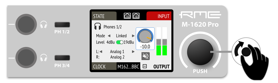

Adjusting the Headphone Volume
The volume of the unbalanced phone outputs can be adjusted separately or as a stereo pair.
Press the PH 1/2 or PH 3/4 Button next to the corresponding headphone output.
Rotate the encoder to adjust the gain.
Open the corresponding output channel strip.
Use the encoder to adjust the gain in the 'PHONES' channel strip.
| Press the Shift key while dragging the knob for finer adjustments. |
| Clicking twice on the encoder knob opens a text field that can be used to input a value using the keyboard. |
Press the Button labeled "Stereo". The button turns grey and a second channel strip opens with its own gain control.
Press the "Stereo" button again to create a stereo channel.
| Any previously created gain offset between left and right channel will be ignored when joining the channels to a stereo group. |
In addition, the overall output level can be adjusted between +4 and +19 dBu for each phones output (+10 dBu and +25 dBu in balanced mode)

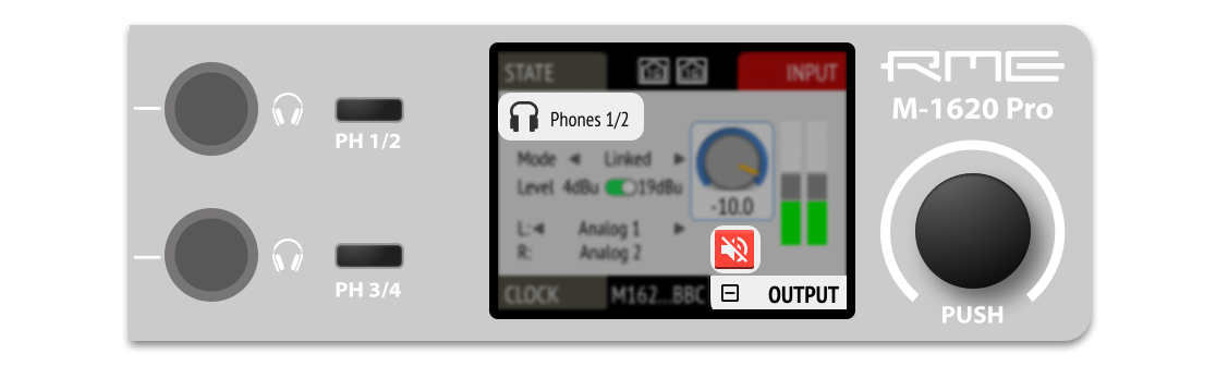

Muting the Phones Output
Press the PH 1/2 or PH 3/4 button next to the corresponding phones output.
Confirm the current output gain by pressing the encoder once.
Turn the encoder to highlight the MUTE button.
Press the mute button. It turns red to symbolize that the phones are muted.
Press the mute button in the Phones output channel.
