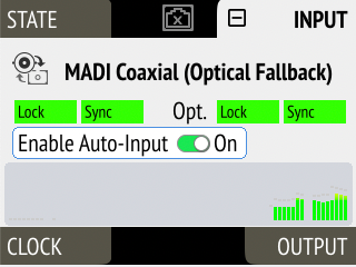

Connecting Two Identical MADI Signals for Redundancy
The coaxial MADI input can be configured to automatically switch to an existing MADI optical signal in case the coaxial signal fails. While existing routing and clock settings from the coaxial MADI input are kept, the port’s name is changed to MADI Auto Input and its icon changes to reflect the feature. The failover is seamless if the active input loses lock abruptly (e.g. one of the cables is unplugged).
wAL 220 3T 3
The user is notified of the lost signal with a warning and redundancy can be re-established.
For a seamless failover, the two MADI signals must be identical. However, only the SYNC and LOCK states are evaluated to confirm the current input state. It is therefore possible to send two different signals to the M-32 AD Pro as long as they are in sync.
To create MADI redundancy:
  1. Switch on "enable MADI redundancy" in the coaxial tab of the INPUT section. The port will be renamed to MADI Auto Input.
    Coaxial Auto Input
  2. Create a routing from MADI Auto Input to any output.
  3. If the device should also slave to MADI Auto Input, choose it as clock master in the CLOCK section.
  4. Connect both MADI signals with identical audio.
