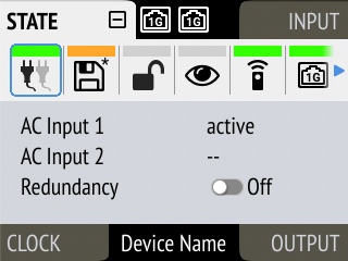

  1. Open the power tab in the STATE section
    Power Tab in State section
  2. The state of each power input is shown as active if it receives power.

  1. Open the power tab in the STATE section.
    PSU Tab in State section
  2. Toggle the switch Redundancy to On.
