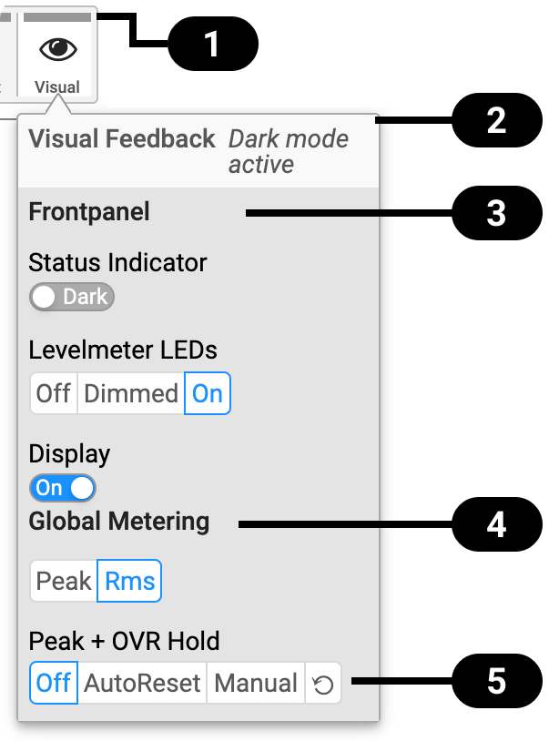

To turn off illumination on the web remote:
  1. Connect to the device remotely (see: Remote Control Overview).
    w322 140 2T 3
    wAL co 1
    Status Indicator
    wAL co 2
    State of Visual Feedback
    wAL co 3
    Front Panel Dark Mode
    wAL co 4
    Global Metering Options
    wAL co 5
    Peak/Over Hold Reset
  2. Use the corresponding toggle switches on the web remote to switch off device lighting.

The remote shows an over notification above the level meter, both in miniature port level meters and the larger level meters when a port is open.
To switch persistant over notifications on or off:
  1. Locate the Visual Settings Tab.
  2. Change Peak + OVR Hold to either
    • 5s to notify for five seconds
    • On to notify until manually reset
    • Off to deactivate over notifications
To reset over notifications:
  1. Within the Visual Settings Tab, use the reset button: wAL 140 4T 5.
