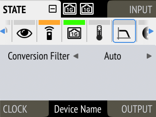

Open the STATE section (see: Use of the Display and Encoder)
Use the encoder to open the filter tab:
Select the preferred aliasing filter.

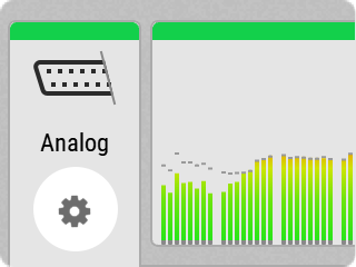

Click an analog channel group to reveal its channels

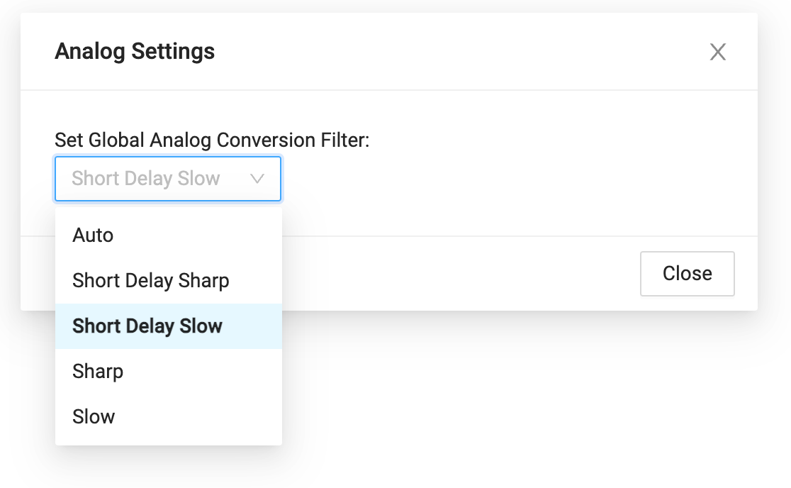

Click the icon that appears within the corresponding analog channel group. A modal dialog appears to change the aliasing filter.
