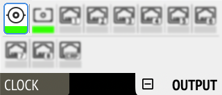

  1. Go to one of the MADI tabs in the OUTPUT section.
    Coaxial Output
  2. Toggle the switch to 56Ch or 64Ch to adjust number of output channels.

To change the frame pattern of both MADI outputs on the device:
  2. Toggle the switch for 96k to use the 96k frame at 88.2 kHz and 96 kHz.
