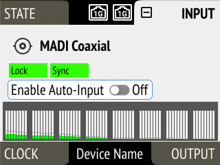

To show the digital level meters on the device display:
  1. Open the input section (see: Use of the Display and Encoder).
    MADI Coaxial input with level meters
On the web remote, each input and output port has integrated level meters. wAL 140 5T 3
When opening the ports, larger levelmeters are shown with precise levels for Peak and RMS values.
