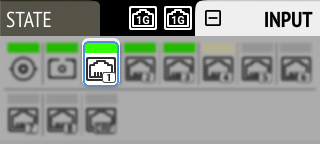

AVB input streams are monitored as follows:
Description Indicator Possible solution
Disabled
grey
Create connection with ATDECC controller
Streaming/Receiving
green
No Data
red
Verify proper talker configuration
SR Mismatch
red
Verify that the sample rates of talker and listener are identical
Waiting
yellow …​
Waiting for talker to be ready
Talker Fail
red
No Bandwidth
red
Use faster network speed (1 GBit/s instead of 100 MBit/s)
Domain Boundary
red
Reconnect all devices and reboot switch, ensure only AVB switches are used
Internal Error
red
Reboot device
