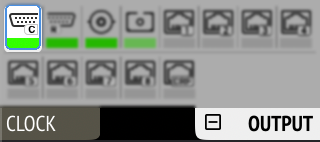

  1. Open the Analog Output Configuration tab in the OUTPUT section.
    wDA2 310 2T 1
  2. Initially, the cursor will highlight all output channels. To accept this, rotate the encoder to move the cursor to the current reference level.
  3. Alternatively, pressing the encoder on the channel strip allows the selection of an individual channel.
