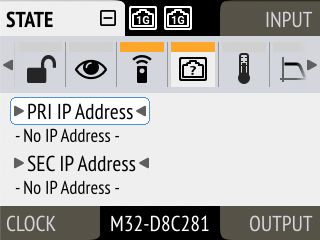

After connecting the primary or secondary port of the M-32 DA Pro II-D to a network, an IP address will be automatically assigned by a DHCP server that is present on that network. If there is no DHCP server on the network, the device assigns itself a link local address (in the 169.254.0.0/16 subnet) that can be used to connect to the device.
Open the network tab in the STATE section.
The current IP addresses of both networks are displayed.
Enter the IP address of the corresponding network in the address bar of the browser.

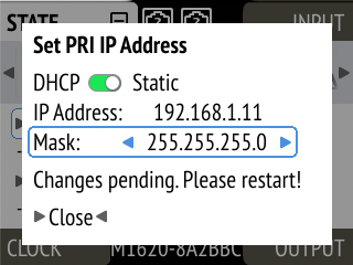

Assigning a Static IP Address
A static IP address can be assigned for each network port. Other devices with IP addresses in the same subnet can then reach the M-32 DA Pro II-D using a fixed IP address.
| The static IP address configuration is persistent and does not get deleted when a preset (or factory preset) is loaded. |
Open the Network tab in the STATE section of the main menu.
Select either PRI IP Address for primary or SEC IP Address for secondary network.
A window is shown to enter IP address and subnet mask. The IP Adress can be configured when the toggle
is set to Static.
Restart the device for the changes to become active.
