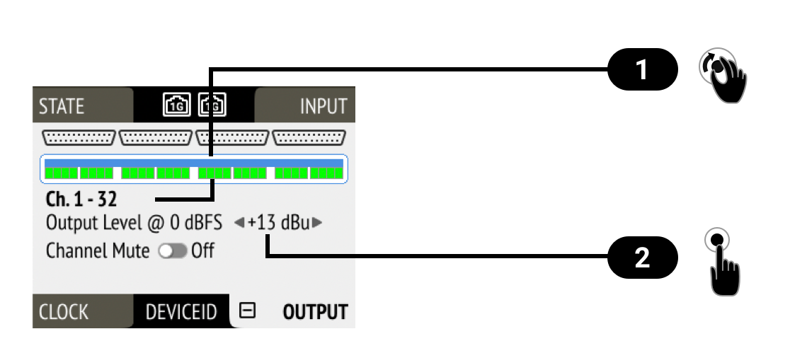

Adjusting the Output Line Level
Open the Analog Output Configuration tab in the OUTPUT section.
Initially, the cursor will highlight all output channels. To accept this, rotate the encoder to move the cursor to the current reference level.
Alternatively, pressing the encoder on the channel strip allows the selection of an individual channel.
Cursor (current channel)
Output Reference Level
Move the cursor to the current line level and push it.
Rotate the encoder to change the setting and confirm by pushing the encoder again.
Select an analog output channel by clicking the corresponding channel strip. The channel strip turns blue.
(optional) Click and drag left or right to select multiple channels.
Press one of the buttons for +13 dBu, +19 dBu or +24 dBu below the selection. The selected value is shown within the level meter.

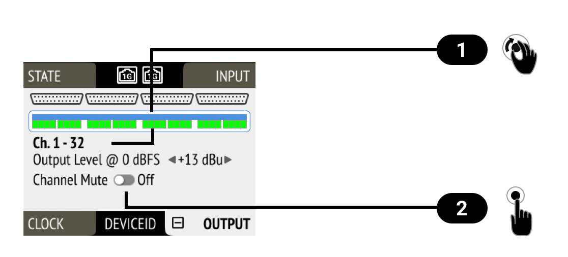

Mute Analog Outputs
Initially, the cursor will highlight all output channels. Press the encoder, then rotate the encoder to move the cursor to the channel that should be muted.
Channel Mute
Move the cursor to Mute Toggle and push it.
Toggle the Mute switch. The status is reflected with a red M in the corresponding level meters.
