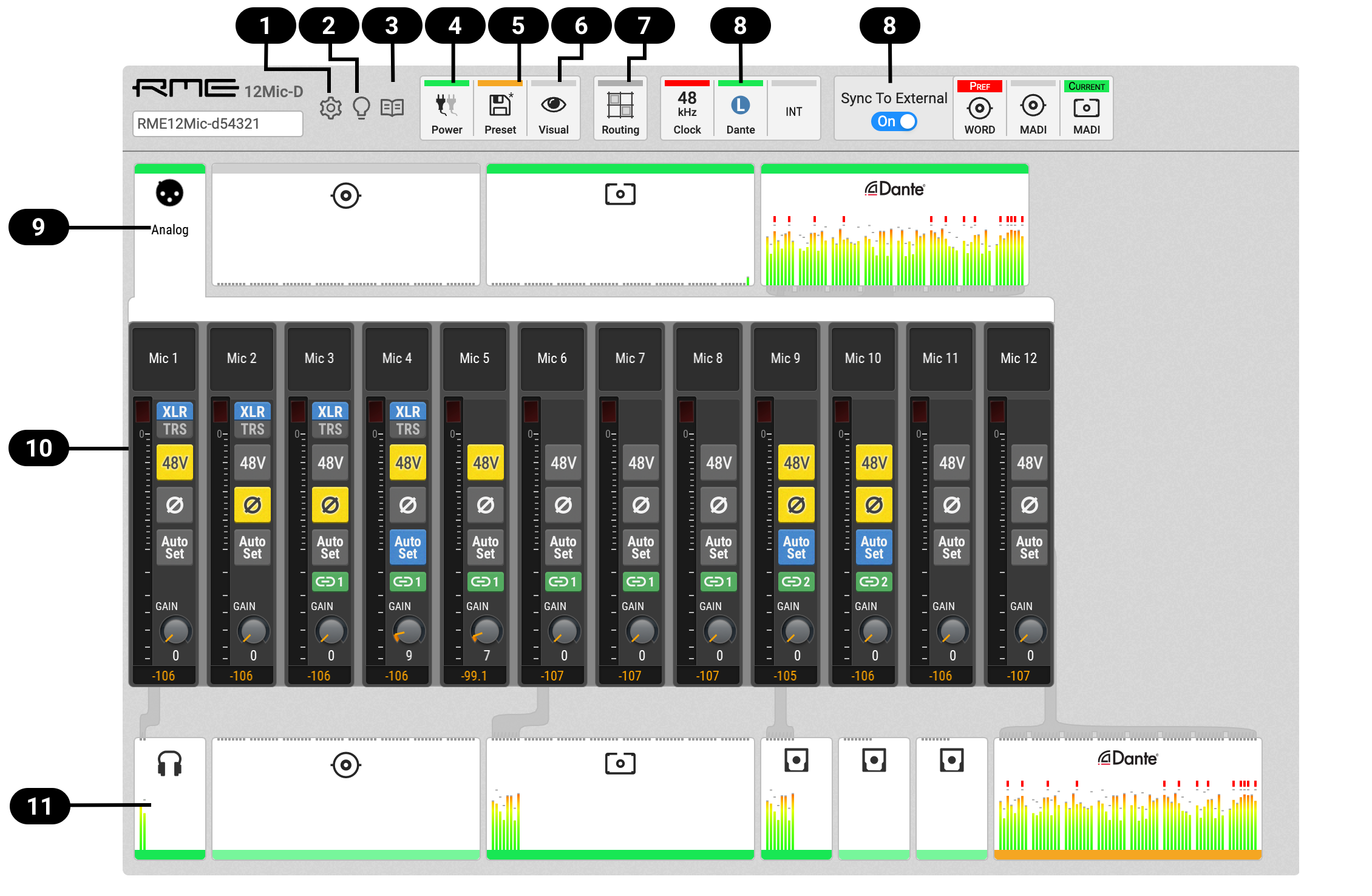

Web Remote
An integrated web server provides an easy-to-use remote control interface for the 12Mic-D. It requires a network connection from a desktop or tablet computer with a current browser version.
Compatible browsers:
  • Chrome 127
  • Firefox 127
  • Edge 127
  • Safari 17.0
    or newer with support for WebGL.
Web Remote Overview
w1D 152 3C 1
wAL co 1
Firmware Update
wAL co 2
Identifying a Device Remotely
wAL co 3
Link to web manual
wAL co 4
Power State
wAL co 5
Presets
wAL co 6
Front Panel Illumination
wAL co 7
Routing Signals to the Outputs
wAL co 8
CLOCK Section
wAL co 9
INPUT Section
wAL co 10
Analog Inputs
wAL co 11
OUTPUT Section
