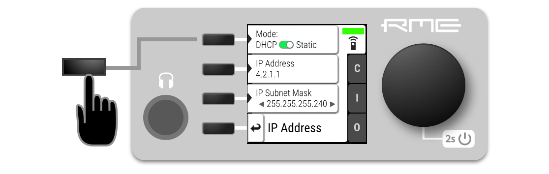

Assigning a Static IP Address
A static IP address can be assigned for the network port. Other devices with IP addresses in the same subnet can then reach the AVB Tool using a fixed IP address.
| The static IP address configuration is persistent and does not get deleted when a preset (or factory preset) is loaded. |
Open the Remote tab in the STATE section of the main menu.
Open IP Settings. The current IP configuration is shown.
Select Change IP Settings.
Toggle Mode to
Static.
Set IP Address and subnet mask using buttons and encoder.
Changes are applied when leaving the tab.
