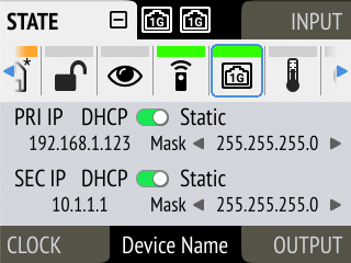

To find out the current IP address:
  1. Open the network tab in the STATE section.
    Network Tab
  2. The current IP addresses of both networks are displayed.
  3. Enter the IP address of the corresponding network in the address bar of the browser.

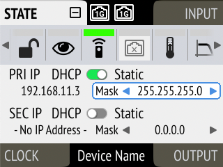

To manually assign an IP address:
  1. Open the Network tab in the STATE section of the main menu.
    Network Tab
  2. Toggle either PRI IP or SEC IP to wAL ToggleOnSmall Static by pressing the encoder.
  3. Navigate to the IP address and begin editing by pressing the encoder. Entering one decimal octet at a time, confirming each with an encoder press.
  4. Navigate to the subnet mask and press the encoder to edit it. This is again performed and confirmed with the encoder.
  5. Changes are applied when leaving the tab.
