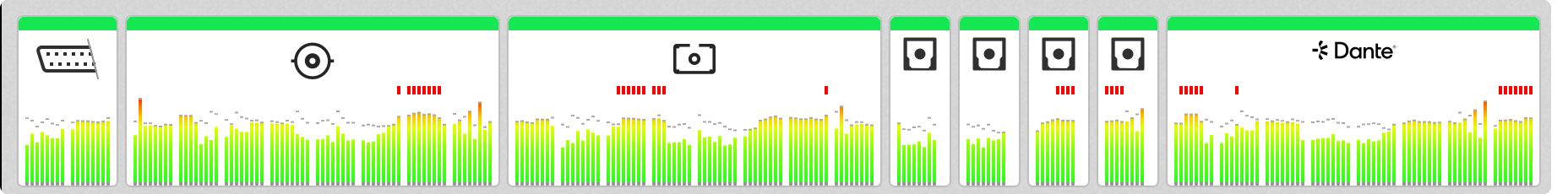

Metering of Digital Signals
The incoming and outgoing digital signals can be visually inspected to ensure that signals are properly received and routed. All level meters adhere to IEC 60268-18 scaling and feature RMS levels with a separate peak indicator. Peak and over hold times can be configured in Front Panel Illumination.
To show the digital level meters on the device display:
  1. Open the input section (see: Use of the Display and Encoder).
    MADI Coaxial input with level meters
On the web remote, each input and output port has integrated level meters. w162D 140 5T 3
When opening the ports, larger levelmeters are shown with precise levels for Peak and RMS values.
